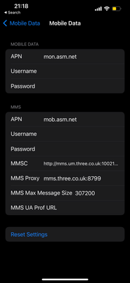

I’m currently in Italy. I’ve changed all my settings to what it says in the website. Added a screenshot for reference. I’ve brought an EU add on (which says works if I have over 12gb of data on my normal plan. And I have 60gb). I also have my roaming on. Is there anyway to get the data  to work?

The mobile data ASN should be mob.asm.net not mon.asm.net
