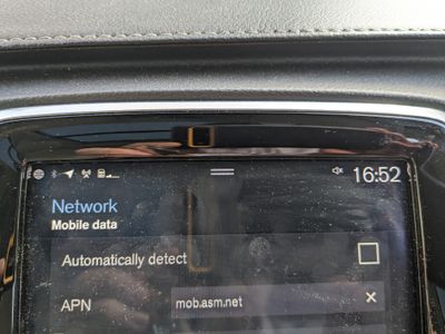

Ok, think I may have found out how
Settings > Communication > Car Modem Internet > Network > Mobile data
